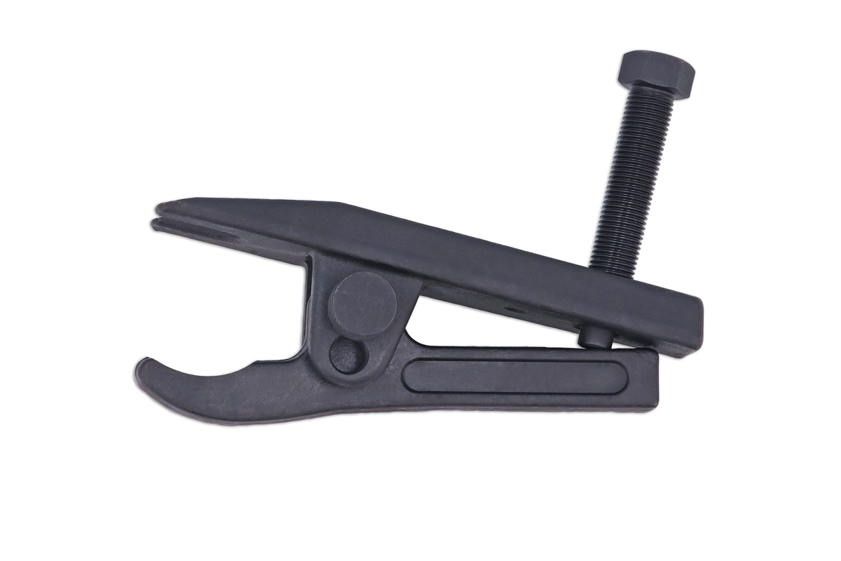

Neither. Go rent the ball joint separation tool from AAP like I did and make your life easier.
Agreed, or just buy the one from Harbor Freight that looks like this one. I've used it to separate large ball joints on my BMW that hadn't been dissembled in 20 years. It worked just fine:
I had one like that, snapped after about 10 uses. I did really crank it down. My suggestion is as it starts getting tight(and after each rotation) strike it hard with a hammer, or an impact. The compression and impact will release even the worst stuck joints.
Well you should strike/tap the ball joint head, not the tool. Sometimes that releases it with very little pressure from the separator.
