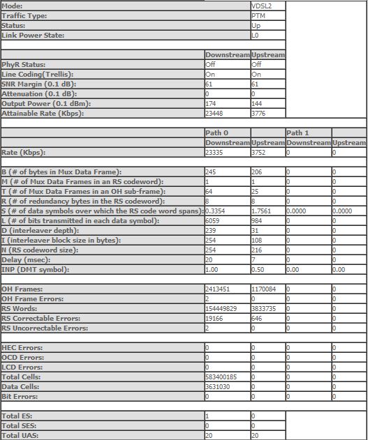

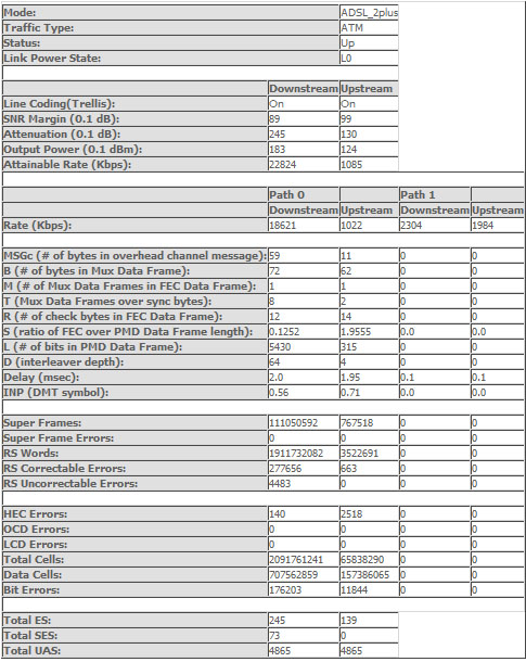

RCO is the percentage of available line space you currently occupy. I'm at 99%, LOL wink
So for example if you are able to synch at 14Mbit but are rate limited to 7Mbit, you'd be using 50% RCO smile
SNR looks decent, I was able to drop 2dB with the install I did that was similar to yours. Any idea on what it was before the revamp?
To give you examples, here's my current sync (VDSL2):
Sync before I went VDSL2 (ADSL 2+):
I'll see if I can dig up the Cisco one, as it looks a bit different (when I was using an ADSL2+ HWIC instead of the stand-alone modem).
