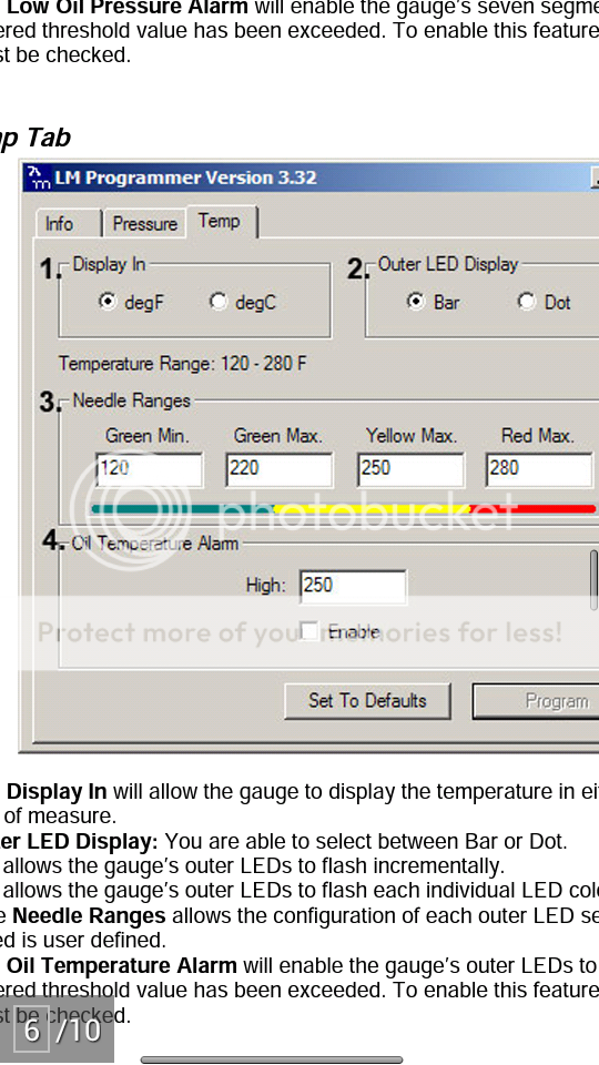

Just bought a gauge that is programmable for warning and whatnot.

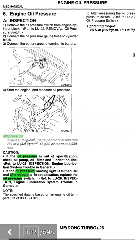

What should my readings be with t6? What should i set my low pressure alarm at? Factory says this.
ALSO, what about temps? Ranges are as shown.. I want green to be 120-? Then yellow and red should be what. What should I do about high temp alarm? What should I set it at? Thanks!

If low is 14psi on 30wt I would say 15-20psi on 40wt should be fine as the low. Low pressure is more of a concern than high PSI in my experience monitoring my Honda motors, I have never got it hot enough to lose enough PSI to be in trouble at idle though.

I wouldn't set the warning any higher than 5 PSI. Yes, 12-15 may be the normal minimum you should expect, but there's no need to trip an annoying warning for random dips below that level.

Most factory lights come on around ~7psi...

12 psi
