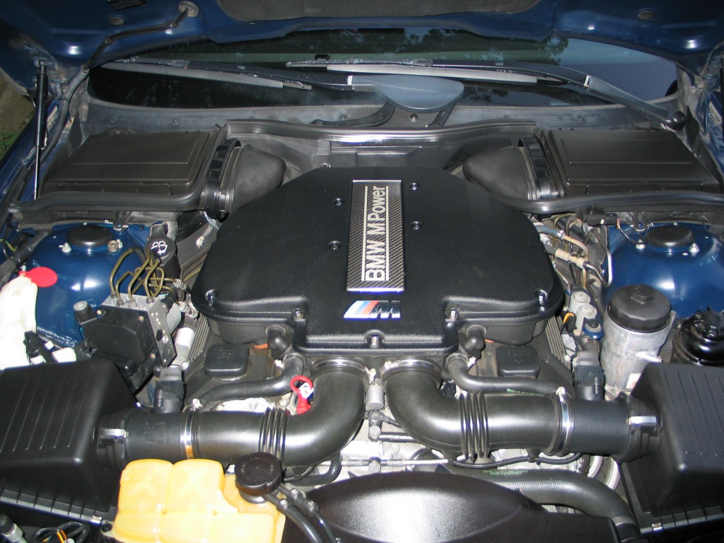

Stupid, stupid design... Sounds very similar to my wife's vw which is set up the same way. Only difference is that it uses a standard filter socket thing available anywhere.
I love cartridges, but when they are up top like on my Mercedes, BMW and saab cars. Couldn't be a cleaner or more perfect way to change the filter.
The wife's I tears was the worst thou. That filter would spill all over everything and always make a mess. Charm of an engine, fortunately it was easy on oil at 7500 OCIs. Technically the filter was only to be done every other time.

Nothing beats the setup on the 2.2/2.4 GM Ecotec. Right on top of the engine, no special tools and not even a drop of oil when changing the cartridge.

The cartridge filter housing should be on the top of the engine near the front, like the one in 2000 MB E430. It take less than 60 seconds to remove the filter holder, 1-2 minutes to replace the 4 o-rings and the cartridge filter.

Very similar to BMW:
Fill cap is on the left valve cover in the above image. Cartridge is on the right side of the engine.
You can use an extractor down the dipstick tube if you desire and remain perfectly clean. I've been too cheap to buy an extractor so I use the drain plug.

Also note in that BMW photo that the filter housing has accomodations for both a special cap wrench (or at least it appears that way) as well as a standard socket, albeit a large one. I've used slip-joint channelocks on my Aunt's old 530.
jeff
jeff
Yup, IIRC, it is 24mm. I just use a 1/2" ratchet with the necessary socket on it.
