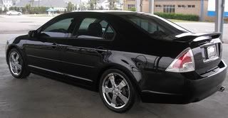

bret, I went on real light this time. I found the Z-AIO very difficult to spread, but I used your instructions and it came off easily with no streaking or smearing. I followed it up with CS (I'm learning that one too...probably used a 1/2 ounce instead of 1/4 ounce...I'll get that one too). When all was said and done, I used the Grand Finale spray and it turned out great...thanks for your help.
http://i209.photobucket.com/albums/bb148/globey_bucket/P62303022.jpg
The car looks great! Well done.
