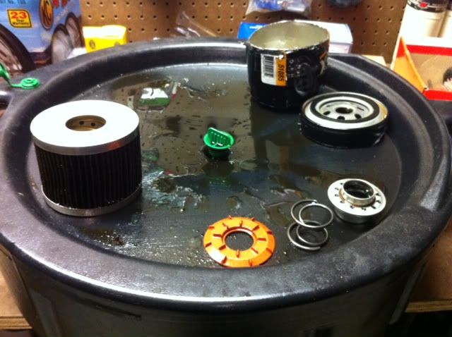

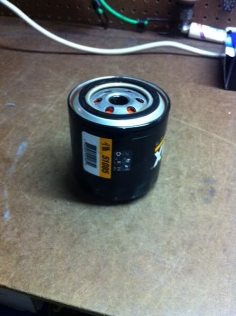

This is the Wix 51085 filter that was run on my buddy's 2001 Jeep Cherokee with the 4.0L engine. It was run for about 5,000 miles with Pennzoil Yellow Bottle 10w30. This Jeep is used for mostly short trips and he drives it pretty hard. When it came time to change the oil, I decided to hack open the filter... literally with a hacksaw.

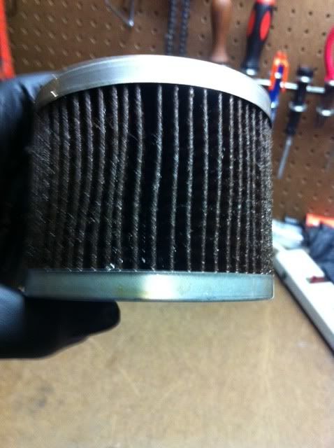

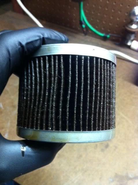

The filter was in good shape, nice straight media and sturdy construction. I'm going to run these Wix filters on my own Cherokee from now on.
Wix make some of the most appealing looking filters. The polished end caps just make the thing sparkle, Wix have some of the most precise media and end caps.
I was impressed by the construction of the Wix filter. I've cut open a few different Purolators and the Wix felt much sturdier. I've used Purolators for a few years now, but for certain applications I will be switching to the Wix.
