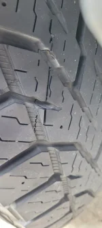

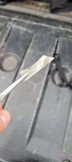

I saw something shiny poking out of my tire this morning pulled it out and was greeted with this two inch piece of razor blade.
It only seems to have cut into the tread and not the tire itself but what to you guys think safe to drive on or get it replaced?
I'd hate to replace it plenty of life on it yet but I don't want to deal with a blow out either.

If it's only in the tread I'd ignore it. Like Jetronic says, you have another sipe now. If worried, you could take a probe of some sort, pick, screwdriver, whatever, and verify that it's not deep.
I wouldn't worry about it. The steel belts are the outer layer, and unless you can see a glint of severed steel in the bottom of that cut, I don't think there is any real damage to the structure of the tire, just a bit of a cut in the rubber that already has blocks and sipes.

Just poked at it again. It's Deeper than the wear bars on the tire but no hint of the belting so based on what everyone is saying it's probably fine.
I would investigate further.
1. I'd slide something thin in that space, maybe a credit card or butter knife, to test the depth. If it's deeper than the grooves, it may be dangerous. Replace or patch. If it's shallow or not deeper than the grooves you're likely ok.
2. Pour or spray some soapy water on the area to see if there's any air leaking. If there's leaking air it will bubble. Replace or patch.
3. It's hard to determine from pictures but if tread depth is low or tires are old (6-10 years) or any weathering/rotting around the sidewalls, it's time to replace. This damage just reinforces that notion.

I'd at least put a spare on and have a professional look at it, maybe proactively patch it. Or if aged/weathered and/or low tread just replace as a set.

I'll probably have someone look at just to check. I don't think it can be patched though the cut is about 4 inches long.
I'm going to try to avoid replacing them unless necessary. They're only a couple of years old and have a bit more than half their tread left.
