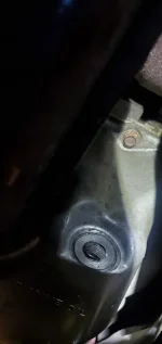

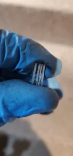

An update/resolution. When I changed the oil this week, the threads were loose in there, not attached. Strangely, it seems that I lost the outter 70% of the thread depth, but there was still perfect shallow threading there. The old pan bolt was able to thread in normally and feel secure. Much to my amazement.
I bought this intentionally slightly oversized hollow pan bolt. Seems to be a secure solution. Keeps me from having to drop this oil pan and do a timesert.

Are there at least 2-3 threads nearest the head of the bolt?
I have been burned in situations like this. It will feel fine for now, but without enough threads, the bolt will loosen up after some heat cycling.
