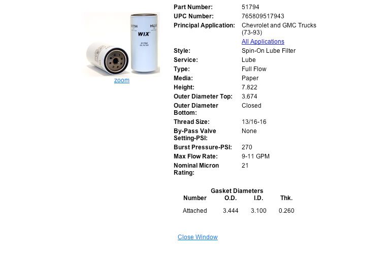

This is the OEM replacement filter for the Camaro engine.
The is no bypass valve on it.

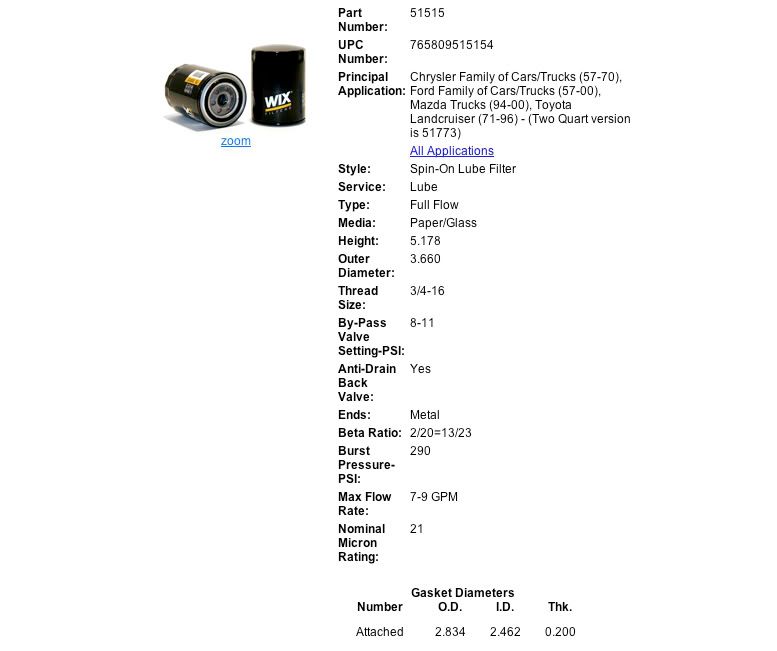

Here is the PH8A style filter used on the remote mount oil filter setups..
It has a bypass valve on it, will this harm the engine at all?

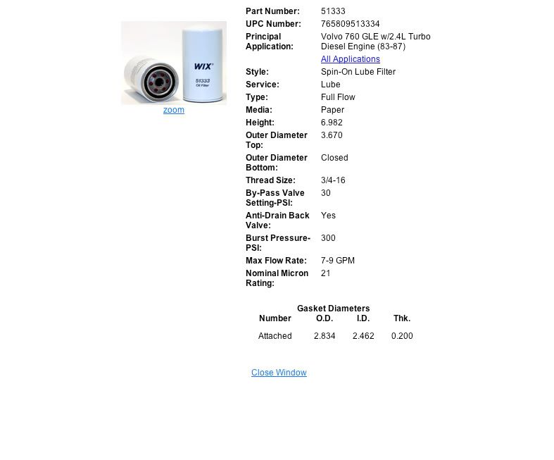

Here is the oversize I found for the PH8A...
It too has a bypass valve.
Is it bad to use a filter with a bypass valve on an engine that has a filter without one?

I think I may run two of the volvo filters.
