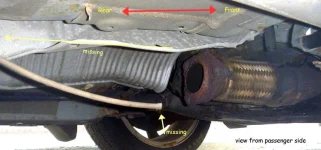

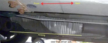

Looked today.
Unless the pipes rusted through on both sides of the catalytic converter and burst through the heat-shield while the car was parked, and it fell off and rolled far away, the P0141 is explained as mentioned above.
Admit I'm morbidly impressed. Must have been fast and quiet. And there's less than a 3 hr window between the late-to-bed and early-to-rise with the sun crowd around here this time of year.
