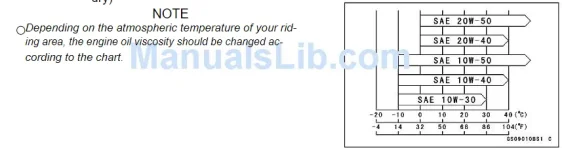

Yes, here is a copy of the graph provided in the manual. To me it would suggest I make the switch, as the 10W-40 bar ends sharply at the 104°F mark.
I'm just not familiar enough with the actual properties of engine oils, and can't wrap my head around any potential benefits and drawbacks. My initial thoughts are that the difference should be minimal, and that sticking with 10W-40 is extremely unlikely to grenade my bike; on the other hand, I also like to maintain my bike to the best of my ability, and don't like the idea of running outside spec. Why is a higher weight oil more desirable for hotter climates? Are there problems that could come from running a higher oil weight? I'm finding that more research just leads to more questions.
Interesting chart.
Most every chart I have seen seems to always show 10w-40 going all the way to the right along with the xw-50 oils.
I do agree the chart seems to show that a xw-50 weight oil is needed.
