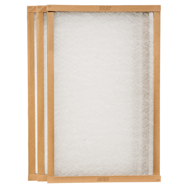

Depending on the Merv rating on the filter it could look clean but be plugged up enough to restrict air-flow. Try a Merv 8 filter, or a filter that looks like this. These offer the worst filtration but best air-flow:
[Linked Image]
