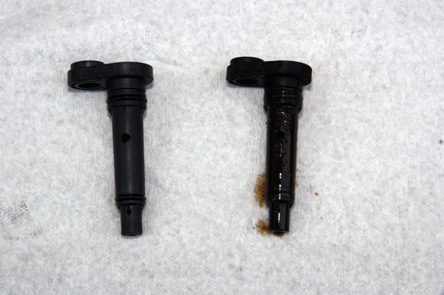

Just changed the PCV valve on my 06' Odyssey. Somebody here suggested a bad PCV valve might have been a contributing factor to the oil leak I've been trying to fix. When I pulled it out, it was covered in oil and did not rattle when I shook it. I have the new PCV valve in the picture also for comparison.

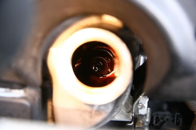

I also took a pic of the inside of the crankcase. It definitely does not look as good as my wife's 07' Accord V6(130,000 miles. Inside looks brand new. No gunk or any staining whatsoever)
When I bought the Odyssey back in December 2011, it already had 115,000 miles on it. Right now it's sitting at 130,000. According to the Carfax, the car had all maintenance done at the dealership. Makes me wonder if the former owner actually brought the car in for oil changes in a timely manner. Or, could it be from the Cylinder Deactivation bit? Just don't know. I'm currently running Peak Synthetic in it. I plan to either use Maxlife or PU (Hooray for WM clearance sales!)next on 5000 OCI's in an effort to clean it up/out a little, if that's even possible.
changing PCV valve is not done as normal maintenance...clogged pcv valves can increase pressure and THAT can cause leaking seals...and worse.
...you may have changed the FACTORY installed valve...good thing you did.

I'm hoping this is what was causing the leak, although I'm not going to hold my breath. I'm not THAT lucky.
Change it every year, it's cheap insurance. Also, check any hoses to see if they're gunked shut, or constricted.
I also changed the valve in our Accord. It had a little bit of oil on it, but looked way better than the one in the Odyssey and it still rattled a little, though not nearly as loosely as the new ones. Overall, I'm glad I changed them. As a bonus, the valves were actually oem Honda parts even though they came from Advance Auto.
