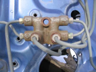

Yes the car has a what looks like a prop valve to me on the firewall. It is just the stock one.
It looks pretty much like this:
http://www.galantvr4.org/img.php?id=61558&width=400
Is that a brake prop valve?

Bin that thing and I bet its going to work as it should. Also I don't about the load sensing one in the back, I have a feeling they need to go also but try it.

The only reason I am not certain it's the brake prop valve is that the FTO and my car seem to share the same part number for it.
Anyway, either which way I will try and hope it does fix the issue
In that case remove the one(s) in the rear with an empty block. One or all of these things are causing the trouble not the MC. 4 wheel disc brakes don't use these things. When I did a rear conversion on a 69 Chevelle SS it was the booster, MC, dist block and 4 lines, that's it.
