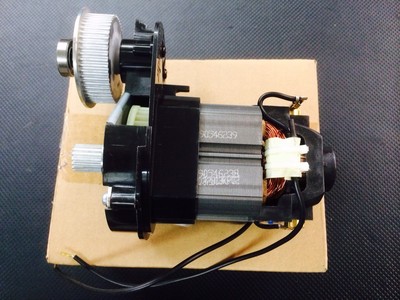

Was able to take it apart. The one tricky thing was a single screw that was hidden behind a label. I just had to peel/tear off a little bit to uncover the screw. Also - I needed a #2 Phillips screwdriver deep enough to reach some of the screws. A #1 Phillips wasn't able to handle a few of the heavily torqued screws. A handle with changeable bits had too wide a shank to reach. Once that was taken care of, I looked at it and figure that it's not worth fixing. Unlike the version in that video, this one has a large nylon gear connected to the shaft. Some of the gear material has melted and is stuck to the teeth of the belt. Something tells me that a new belt isn't going to fix this.
I was curious and tried to find out how much a new gear would cost. I can't find any place that has just the gear and I wouldn't know how to remove it. It's held in place with two cartridge bearings. About all I could find was a complete replacement motor assembly, which doesn't actually come with the metal geared drive pulley. And the only replacement I could find had a metal gear and not a plastic one like I see in this damaged trimmer. I'm thinking the one with the metal gear is interchangeable, but it's over $110, which is more than I could buy a current complete equivalent trimmer. Here's a photo of one:
I guess these are more or less disposable. But if this one had the metal gear, I don't think it would have melted although the belt might have worn faster.
