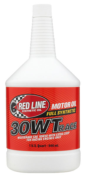

Sure anyone can recommend a 40 or 50 weight, even a HP robbing conventional diesel oil. It's NOT what the OP wants.
I think Redline 5W-30 is a good recommendation to go along with RD30 10W-30. Any others? Maybe a M1 5W-40. Maybe Amsoil 10W-40.

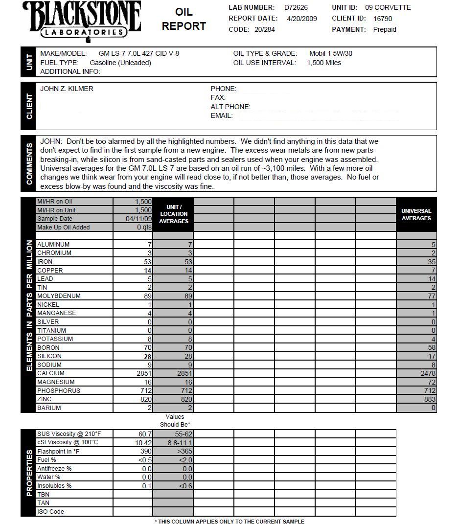

Thanks for destroying this thread AJ.
The Mobil 1 held up better then the Amsoil, but not much can be determined by two UOA's.
No problem. I'll be shure to get your permission before posting some other Corvette UOAs for the original poster. I didn't think it had anything to do with you, but if you say so...ok.
I can pretty much guarantee 15w-40 would produce a better, if not ideal, result than what was already used or anything mentioned so far, but nobody wants to hear that because it's too obvious.

Originally Posted By: Pablo
Originally Posted By: ADFD1
Seems like two track days made the difference? He hit high rpms with the Mobil 1 oil as well as the Amsoil. Only difference in his comments was 2 track days. I would have thought the Amsoil would have held up just a little better than it did? hide
Oil held up fine. Show me the signs of degradation. Yes two track days can make a huge difference. Some people are just confused - Amsoil ASL 5W-30 is NOT a racing oil, not a high P monster cam protection oil. It's a long drain street oil. I just don't get why people don't understand this.
Maybe "held up" was a poor choice of words. "Didn't protect well in this app" might have been a better choice of words. What oil is spec'd for the engine? If it is 5W30 then the oil didn't do such a good job IMO. RL might be a better choice. Does GM call for a racing oil for this car? My guess is people who buy them use them for some spirited driving. If so maybe they should state use a racing oil?
Go easy here I want to learn the value of these UOA's.

Sorry, I didn't mean to come off as harsh or anything. My apologies. I get a bit passionate about these things.
GM calls for 5W-30 per GM4718M. I think spirited driving on the highway is vastly different than race track conditions. RL 5W-30 MAY have done a better job here, purely because it's not an SM oil.
As for the value of UOA's - let's look at this from another angle. Let us assume both of these were race track UOA's (not just the Amsoil). Although Amsoil has a bit better base oil combination, a bit higher B and is a long drain oil - it's not that much different from M1. I mean look at the viscosities and the other additives. That said - what is the problem that is inflaming everyone's anuses here? Fe. Almost all the other metals are UOA identical. Both have relatively high Cr and Ni - where is this coming from? Probably rings - break in or wear? Probably a little of both. But most likely during extended full throttle racing conditions the rings were contacting areas and taking shapes/angles that just didn't happen on the street. GM doesn't necessarily specify their street oils for such conditions. Then there remains the elephant in the room. What if there is a problem with the engine? I'm not saying there is, nor do I want the OP to worry, but looking at these two UOA's cannot rule out that possibility. The weaknesses of single pass UOA's raise their ugly head.
Would a 40 or 50 help? Maybe. Heck you could try Amsoil 15W-50 Racing Oil.
Amsoil RD50 Racing Oil
