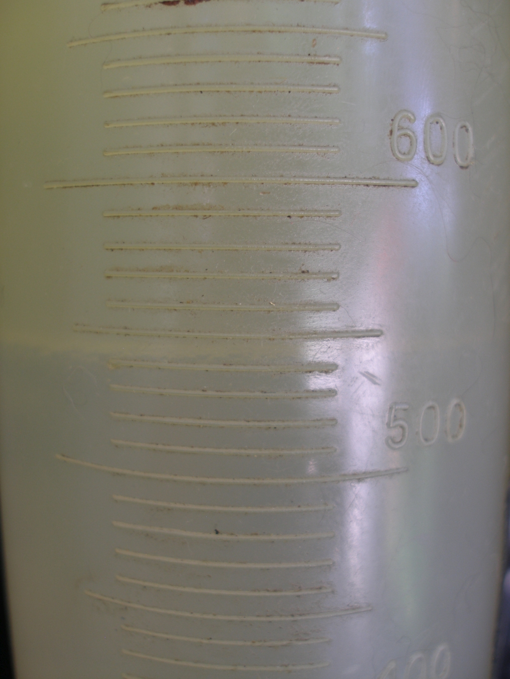

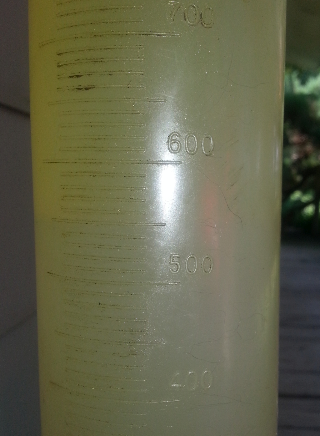

Ok here's what I did. I have a 1000mL graduated cylinder that is marked every 10mL I have a gram scale and hydrometers, one .700 to .800 and another .900 to 1.000 both are 60/60 temperature rated. My thermometer is one degree graduations.
I used demineralized water at 68F and measured 1.000. Temperature correction is +.007 so I'll forgo them for this experiment.
E10 Gasoline SG was 0.730 at 68F, 500mL of it weighed 362
grams.
Water was 68F and 500 mL weighs 500 grams.
So after pouring in 500 mL of E10 and adding 500 mL of H2O I ended up with around the 550 H2O and 450 gas.
This kind of hard to see but if you look to the left side of the cylinder at the 550 mark you can see the line.
Here's another shot, the angle isn't the same and it's a different camera.

Congratulations you just lowered the octane of the gas.
How long did it take to separate?

So start with a higher octane?
The separation was immediate.
