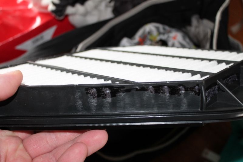

I bought an air filter at walmart yesterday for my wife's car and this is what I notice when I went to put it in...
I never thought that a guy with a sharpie could be considered quality control. I am guessing that fram is buying this filter from someone else.
I did pull the filter out of the box before I bought it but I didn't look at it that close. Good thing I noticed it before I put it in because the gasket was kinda crummy also and it is a pain to get to.

This was the only spot that the media showed through.
I didn't feel comfortable using the filter so I went to O'rileys to get a wix but wound up getting a microgaurd instead. It look good and was cheaper than the fram at walmart and made in Poland. I looked at the only fram for this app that they had and it wasn't as bad as the one from walmart but still had the sharpie covering the media. The gasket on the microguard looked much better than the fram or the factory filter.

Aside from the sharpie and the gasket the fram wasn't to bad. I do like the microguard better. I have not looked at any others to have a comparison.
I think I will bring this to the attention to fram before I return it. It didn't look like it was going to affect filtration but I didn't like it.

I work for FRAM. While the filter is very likely ok to use, we would like to see it. Please contact our quality dept at 800-890-2075. Or you can message me at [email protected], we could swap some filters if you can mail that one to me.
Thanks in advance

I do agree with you that there is probably nothing wrong with it but it is kinda irritating to have the imperfections of the filter obviously atempted to be hidden. That to me says that that is not supposed to be and no one wants to fix it. It makes me question the overall quality of the filter.

Trust me, we are very concerned. even cosmetic flaws are not acceptable.

The micro guard and the eom filter had media sticking through the plastic but no where near as bad. Plus they didn't attempt to hide it.
It is good to hear that you guys are concerned.
