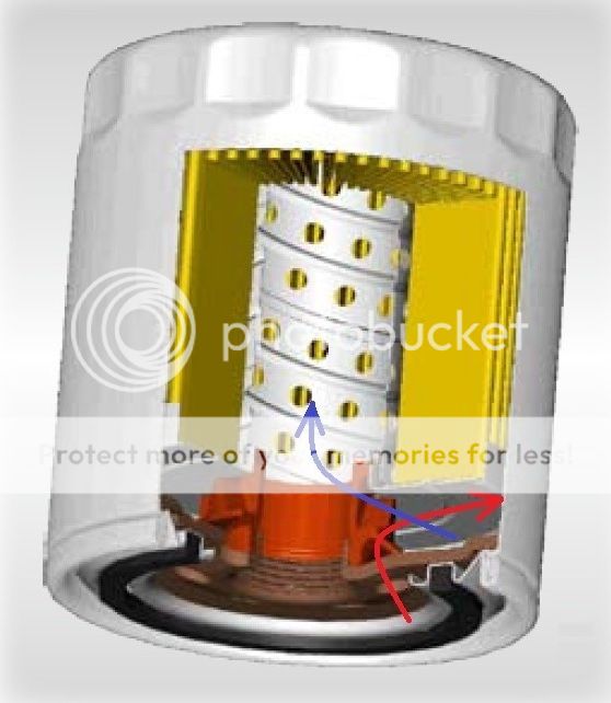

I made this up a while back trying to explain how the combo valve worked. I'm wondering if anyone else can verify if their combo valve was a sloppy fit in the center tube like you found, or a more snug fit like I think it should be.

Sloppy isn't a very accurate term for it IMO. There's a video on Utube of a dissection and it is the same way though. You can barely get it to move, there is a little play it doesn't squish itself in. The ADBV side does.
