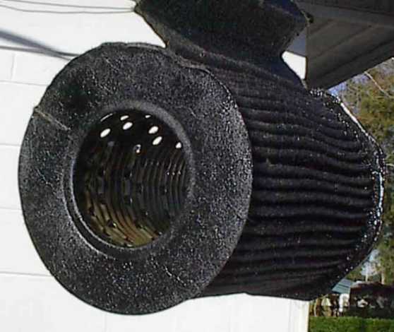

#312439 - 01/09/03 06:39 AM Pics of Purolator Cardboard Endcaps
Ryan00TJ Offline
Registered: 07/08/02
Posts: 742
Loc: Lake Anna, VA
Just an FYI
This is a pic of a Purolator Premimum Plus L10111 oil filter. It is the equivalent to an AC PF-47. Note the cardboard endcaps and string wrapped around the filter media. I'm not saying this is a bad filter but I prefer a filter with metal endcaps after hearing of engine failures due to the cardboard endcaps on Fram filters.

Fram also uses that string trick. I wonder if Fram has any connection with Purolator.....?

The string doesn't bother me at all. [Big Grin] Those cardboard endcraps are another story. [Mad] There's a Pure One on my car now, then I have 4 Wix & one K-Mart Penske(made by wix)to use before I need to buy any more filters. If I should run 9,000 miles or more per oil change(the present plan), those should last quite a while. When I do buy new filters, they won't be white Purolators. [Frown]

They've been doing it for a while too. [Frown] I found cardboard endcaps in one I cut open two years ago. It was in my '00 silverado 5.3L-took it off and opened it up after having a really bad startup noise.

Here's a pic of toyota, purolator, motorcraft, mobil, fram and bosch.
Now here is a pic of a fram with the cardboard end caps with a little over 7,000 miles of use. Notice there is no evidence of deterioration of these cardboad endcaps. Also notice they do use a metal cage to support the inside of this filter to keep the media from crushing inward due to pressure surges. Also, upon inspection, I've noticed that the use of the end caps are that the glue used to hold the media in place so it doesn't shift around, and that the amount of glue used actually supports the endcap as it covers most of the backside of the cardboard. So in effect, you'd have to melt down the glue to destroy that cardboard end. I come to the conclusion that the life expectancy of the fram is somewhere around 7k miles and noticed the engine tapping slightly at that mileage, I then changed it, and it went back to normal.

Even if there were no problems with the cardboard in your filters Bob, on priniciple alone I would never run a filter with these in there. Why? Because obviously if 99% of the filter makers use metal, then they know something we don't. I know it's hearsay, but I've heard of quite a few Fram filters falling apart, and their cardboard endcaps breaking apart. No thanks, I want to be 100% sure of the construction of my filters when I am going to be leaving them in for so long.

Well, understand, I'm not standing up for them but... IMO, we don't know the conditions in which those that did fail, where under. I have myself seen where an amsoil filter failed, it, is constructed well, so does that mean it's a bad design?. Did the frams that did fail, have underlying situations that caused this failure? maybe, maybe those were older designed filters, and now maybe there is some basic minor differences from before?, Purolator, cardboard endcaps? Maybe, like many oil companies that are now mixing blends of mineral and pao to make full synths, some oil filter companies will start using these cardboard end's on more filters because maybe theres more evidence of them actually working than not and this surely would be one way to cut the expense of the manufacturing process to up the profits of the company as well. You can't say fram is the new kid on the block nor that they have no experience so I don't think at this time will I dismiss this as shody just yet. Like many things, many people have heard of the construction of these filters and such, but I haven't heard or seen actual evidence to show where there is a consistant problem with this material used which people call cardboard which IMO, appears not to be such but some other type of paper material which if you think about it, what is most filter media's consist of or had consist of? Maybe paper of sorts?
