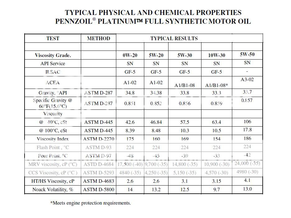

Penz Lack of ACEA Specs bother anyone Else
Originally Posted By: 4ever4d
No,i dont need ACEA specs,GF5/SN will get me by just fine with no problems.
Understand overkill is not necessary but if I can get it at the same price I'll take it.
I can find little on GF4 GF5 or SN oils other than the spec protects your cat and get you every so slightly better mpg.
Is there some useful information out there as to specs for Wear and Deposit control that a GF5 SN would provide. Think I came across something but need to riffle through the multitude of papers I have to find the web link.

OP -- re: your thread title -- it bothers me to no end, since i just used PP for the first time.you state that PP ONLY meets ACEA ... . that's funny.the modern API, GF-5, SN oils are, by nature, overkill.the PP oils are, arguably, as good as you can find.
the "fact" that the SL, and SM oils will kill cats is a bunch of bee sss. there are millions of NA vehicles that use/used SL and SM oils, over many years, with no ill effect.enter the paranoid people.
